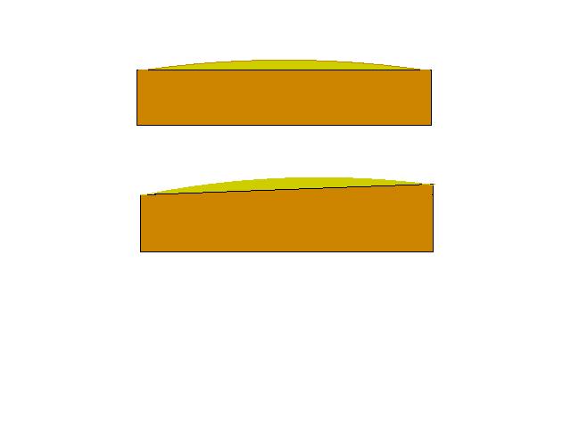

You can move the effective "peak" of your dome by tapering the sides. In the first of two images that follow, the top is mounted to the side such as to make a 90 degree angle from a line from the head to the tail. This put the peak half way between the head and the tail. In the second image, the top is slightly tapered. This moves the peak further back towards the tail and also make for a larger neck set angle.
I try to make my guitars like the first image and let the dome determine the neck set angle. I flatten the upper bout so that the fretboard extension lays flat.

When you radius brace a top, you turn that top into a segment of a given sphere. You can then rotate that segment to any point around the center of that given sphere. Nothing in the geometry of the top changes. However if you offset the two spheres and then rotate the top around the center of the given sphere (The sanding bowl) you affect the rise/fall of a theoretical tangent between the now two separate spheres. Doing this is what I was talking of in my last posting.
Mike showed this well in his example sketchMichaelP39071.4735648148

IMO when you glue up the bracing to the top. You create a segment, a portion of a given sphere. It knows no relationship to the taper of the rim at that point. Like Mike showed in his sketch when you taper and where you start the taper of the rim affects the cord of the sphere segment. By tapering the rim you define a rotation of the top around the axis of the theoretical sphere by rotating the cord line off the true horizontal or zero "X" plane
I may have miss read Marks question. The only time that you affect the where the peak of the dome will be is when you taper and dome sand the rim. That is when the angle of the sphere segments cord line is defined relitive to zero "X" plane.MichaelP39071.5302430556

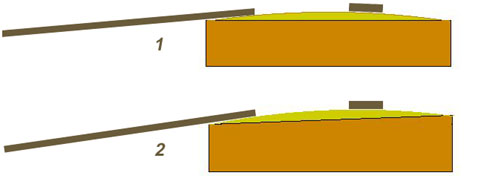

If you look at Mike's two drawings and imagine the neck attached to each of those two bodies, you'll see that you'd have to tip the neck down on the bottom drawing in order to have the fretboard tongue lay flat on the top and have your neck angle right. Now, imagine that neck attached and then lift the end of the neck back up to where it's parallel with the one imagined on the upper drawing. What's different between the two? Nothing about the "peak" of the top or the relationship between the fretboard and the top. What's changed is the geometry of the sides in relation to the rest of the guitar.
The only way to really give yourself substantial leeway for variation in the relationship between the fretboard and the top, or where the top's "peak" is in that relationship, is to use an "elevated fretboard" design.Todd Rose39071.9258680556

Correct me if I’m wrong but shouldn’t we be thinking of the dome apex placement in relation to bridge and fret board angle?
Or, Todd, is this what you mean?
After playing with Mike’s Dome drawing, it appears the bridge and fret board (as a unit) also wraps or folds along the sphere of the dome. I guess if you have done it right, you would always have a slight apex in front of the bridge relative to the bridge and fret board angle in both 1 and 2. Does this seem right?
Maybe I’m missing something?

Yep you are seeing right but keep in mind that in your example 1, the body is is the same depth at both ends. This puts the cord of the segment at zero in the "X" plane and equal to the length of the body. Example 2 the cord is rotated.MichaelP39071.6270023148

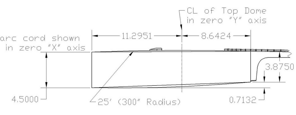

PostPosted: Wed Dec 20, 2006 8:10 am
As you can see with the arc's cord held at ZERO degrees in the "X" axis, the peak or "Y" axis quadrant of the dome is well forward of the bridge on my SJ.
This is for a 25.4 scale 19-15/16" long body with a 25' radius top. and achieves a 1.5 degree neck angle with little sanding.. It does require some sanding but not much.
Remember the side taper is on the back not the top.

I see!
Thanks Michael!
Yes and the sides are tapered for the back not the top. That would have made it tough to get a propper neck set.
You start to see how everything is interrelated.
